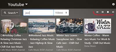

Vụ Youtube Play trên DAstereo
chép lại HD của chính chủ
Added Youtube in search mode
You can play in three ways.
Audio only:
  1. via mpd-youtube, control via the mympd interface.
Video + audio (only audio is also possible, but there is no point in this):
Note: on Youtube in 720p and higher format, video is stored separately from audio tracks.
  1. omxplayer - limited to best quality (usually it's crappy video quality and more or less audio in one file)
    The player does not support external audio track and playlists. That is, it can play Youtube 1080 but no sound.
    Requires gpu_mem at least 64Mb. Changes in HDMI settings.
  2. mpv - video maximum 1080 (since raspberry hardware no longer supports and except for the vp9 codec) and an audio track of maximum quality.
    Requires gpu_mem at least 192Mb or 256Mb, don't remember. Changes in HDMI settings.
Players support rewinding until implemented. But there is a pause, next track, stop. You can watch the concert (Searching for 'Concert HD') or some playlist.
Playlists are currently limited to 50 items.
For video to play, HDMI must be enabled. For video players, I had to stick my own control panel, since it is rather difficult to build it natively into the interface.
When you select the MPV player, the player itself and its libraries are downloaded (~ 20MB). After the message Settings applied, you can use it.
Note: everything works through youtube-dl, itself is not a fast component, so it takes 5 seconds before launching while it calculates the url of the file.
