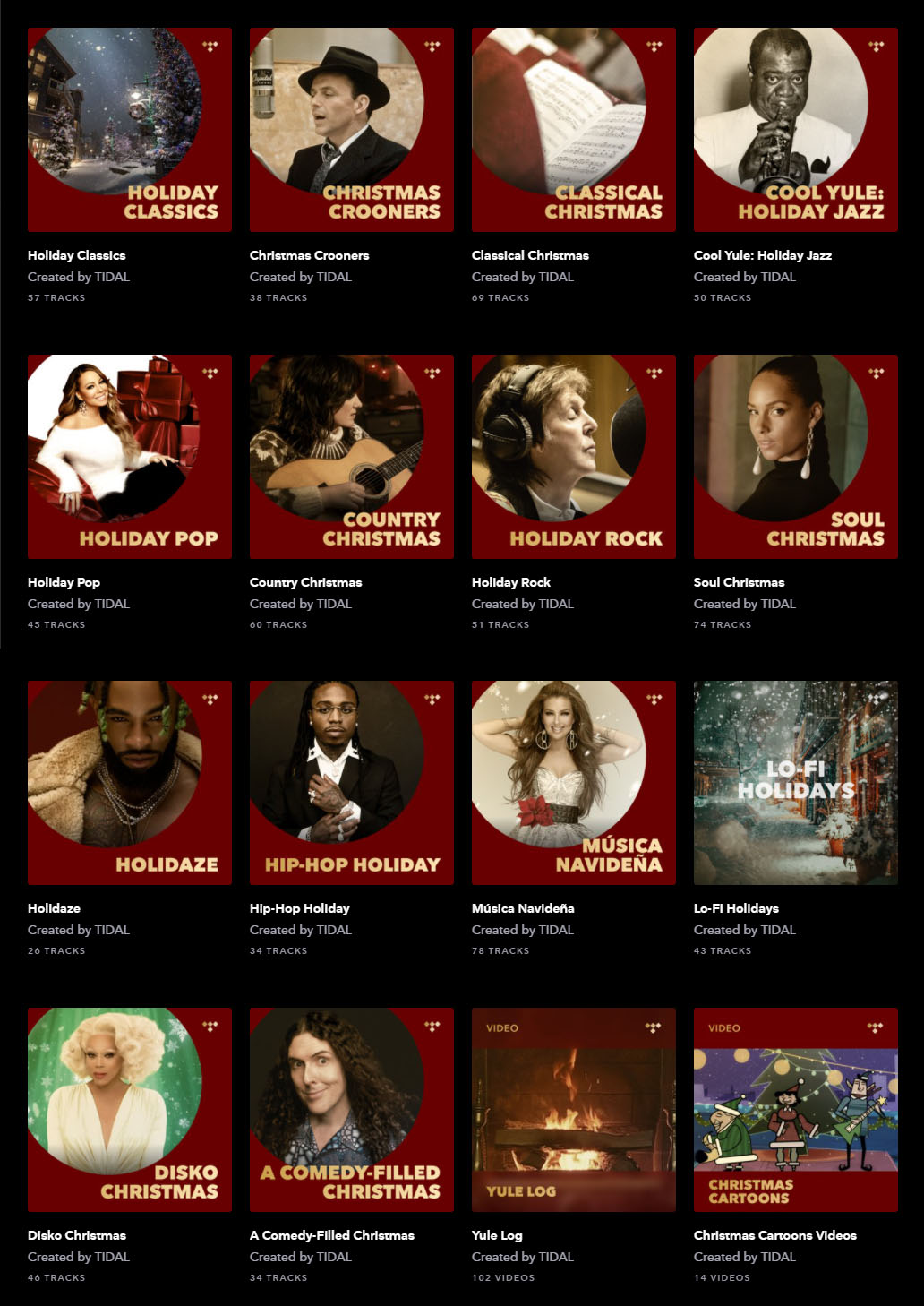

Một playlist rất dễ chịu của Tidal:
Holiday Classics
https://listen.tidal.com/playlist/597d5465-b7d9-4872-80a5-230bdc59ce83
And many more...
https://listen.tidal.com/search/playlists?q=Christmas Eve
