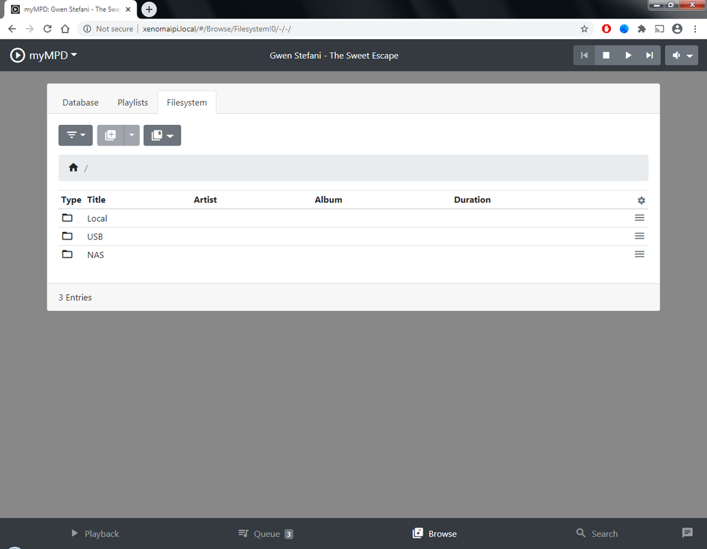

Reboot và kiểm tra lại:
Mã:
pi@xenomaipi:~ $ df -h
Filesystem Size Used Avail Use% Mounted on
/dev/root 3.5G 1.8G 1.6G 55% /
devtmpfs 484M 0 484M 0% /dev
tmpfs 488M 0 488M 0% /dev/shm
tmpfs 488M 6.5M 482M 2% /run
tmpfs 5.0M 4.0K 5.0M 1% /run/lock
tmpfs 488M 0 488M 0% /sys/fs/cgroup
/dev/mmcblk0p1 253M 64M 189M 26% /boot
tmpfs 98M 0 98M 0% /run/user/1000
//192.168.18.2/share 1.9T 1.7T 141G 93% /mnt/NAS
