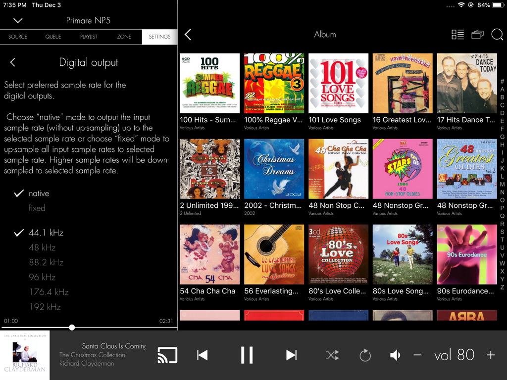

... The next OTA update, to be launched either prior to, or coinciding with, the Roon Ready update, will provide additional options for the digital output. Initially, the digital output was configured to best address connection of NP5 Prisma to older Primare models, up-sampling to fixed outputs to those resolutions that would allow for best performance from those devises (48, 96, and 192).
The new options will allow a user to set the upper output limit (48, 96, or 192), with all inputs at or below that resolution being passed through at their native resolution. So, if maximum output is set to 192, all output of resolutions up to and including that resolution will be at the native input rate - meaning 44.1 in / 44.1 out, 96 in / 96 out, etc...
