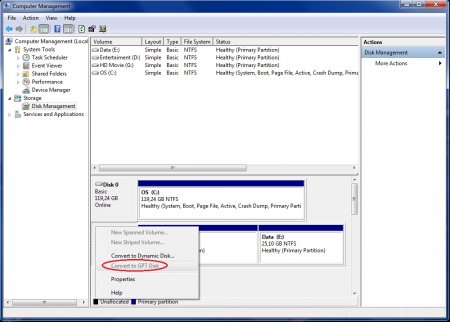

Format bằng Dune thì A-400 ko nhận vì Dune format theo định dạng EXT, bác format bằng Win7 về NTFS thì HDP nào cũng nhận
Từ 2TB trở lên phải dùng bảng mã GPT để Win quản lý dễ hơn, nếu để MBR như với các HDD dưới 2TB thì sẽ bị chia làm 2 phân vùng (phân vùng đầu tiên sẽ tối đa 2TB)
Bác chuyển sang GPT như ảnh dưới nhé, nếu OK thì sẽ đc nguyên 1 phân vùng 3TB
Lưu ý là dữ liệu sẽ mất hết nên bác backup trc khi làm nhé:

Bác chia lại HDD theo GPT như e hướng dẫn bên trên có đc ko, có ra nguyên 1 phân vùng 3TB ko?

8: My 3tb or larger drive is not detected by the pch?
Manufacturers are starting to pre-format >2tb drives for old windows xp compatibility.
It's pretty simple to fix, but I only have windows so I do not know how for other os's:
- install the drive into a computer
- select start->right click computer->manage
- scroll down to disk management and find the drive
- delete all partitions
- convert the drive to GPT
- if you want to use the drive as NTFS, format it with 4K sectors, I strongly recommend also using a volume label that is simple, all lowercase, no spaces or special characters. It will help identify the drive later if you have many, show the name on the screen, and make jukebox paths dirt simple.
- put the drive back into the pch.
Technical explanation:
MBR is how all drives are formated for many many years. But it's limitations do not allow drives larger than 2TB. When 3TB drives came out, 4K sectors (aka advanced format) and GPT was invented to overcome the limitation. Because of how it works, some aged computers and OSs can't support GPT.
Drive makers have come up with a way to trick these old computers and operating systems to work. There is a couple methods to do this but one of them is the reason your having the problem. It's only friendly on old windows computers and the pch is unable to detect and convert it for you at this time. You just need to remove the "trick" drive makers are using to stop returns of good drives and redo the partition table to modern >2TB standards.

Kỹ thuật của bắp rang thì hướng dẫn giống như e
Còn chú khoai tây thì bảo lấy 1 usb trắng (ít nhất 4GB), cắm usb đó vào C-200 format theo EXT3, sau đó cắm HDD 3TB (đã format theo NTFS) vào thì C-200 sẽ nhận HDD 3TB đó luôn
E nghĩ cái usb phân vùng EXT3 đó như usb "mồi" để C-200 "tưởng" HDD 3TB kia cũng là EXT3, thế là nhận thôi (C-200 dùng chip cũ nên hình như ko nhận HDD 3TB)

Thì e dịch theo cái đoạn tiếng Anh bác ấy gửi thôi, trong đó nó ko nói rõ cái usb để làm gì nên e nghĩ thế vì e ko có C-200 để test
Còn vụ HDD 3TB trên A-400 e cũng nghĩ do FW phần cứng thôi chứ ko có lý do gì đã chuyển GPT mà ko nhận cả
