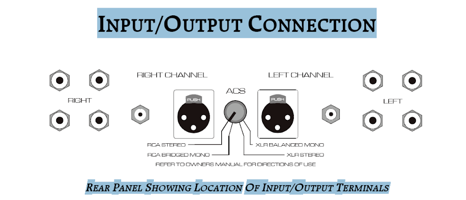

Amply này 2 kênh em thấy sẵn có 4 cọc/chanel để đấu Biwire
có HD đầy đủ: gửi các bác tham khảo, cái ACS ~ AMPLIFIER CONFIGURATION SELECTOR
BI-WIRING
Bi-wiring uses two pairs of loudspeaker cables for each channel loudspeaker. You will notice that the rear
panel of your Amply has two pairs of output terminals for this purpose. When using bi-wires,
connect positive (+) to positive (+) or red to red for either STEREO installation. With a MONO setup
remember that your speaker wires must use the red positive (+) output posts ONLY. No connection is
made to the black negative (-) terminals. Check that you have both your red speaker positives (+)
connected to the amplifier red right hand side output positives (+), and both black speaker negatives (-)
connected to the amplifier red left channel output positives (+).
