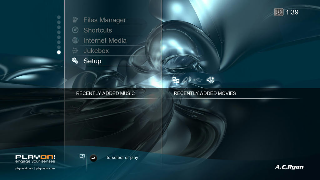

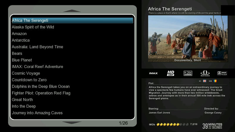

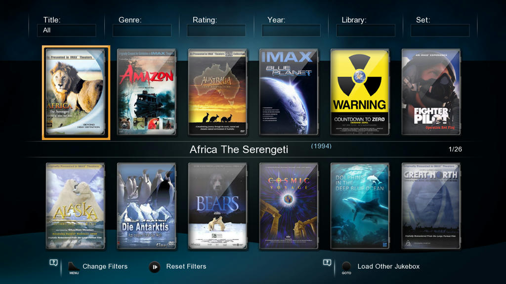

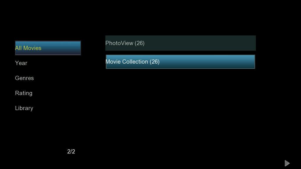

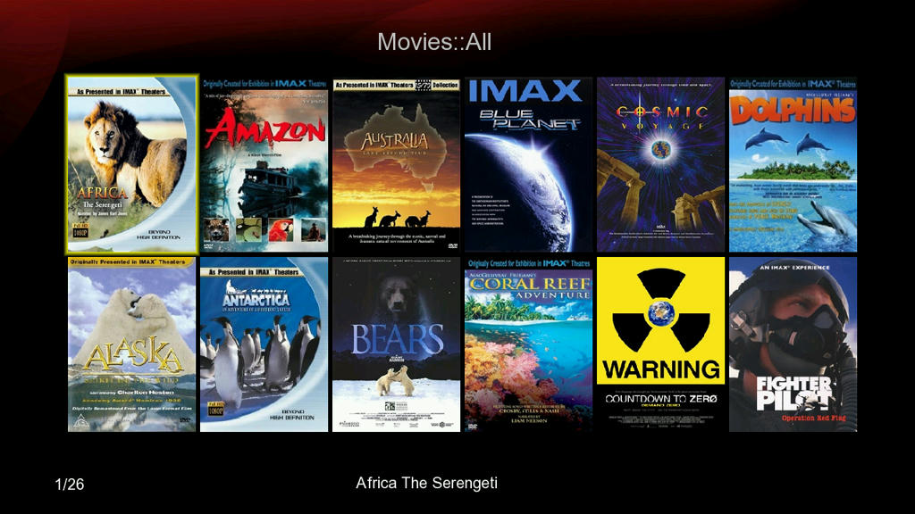

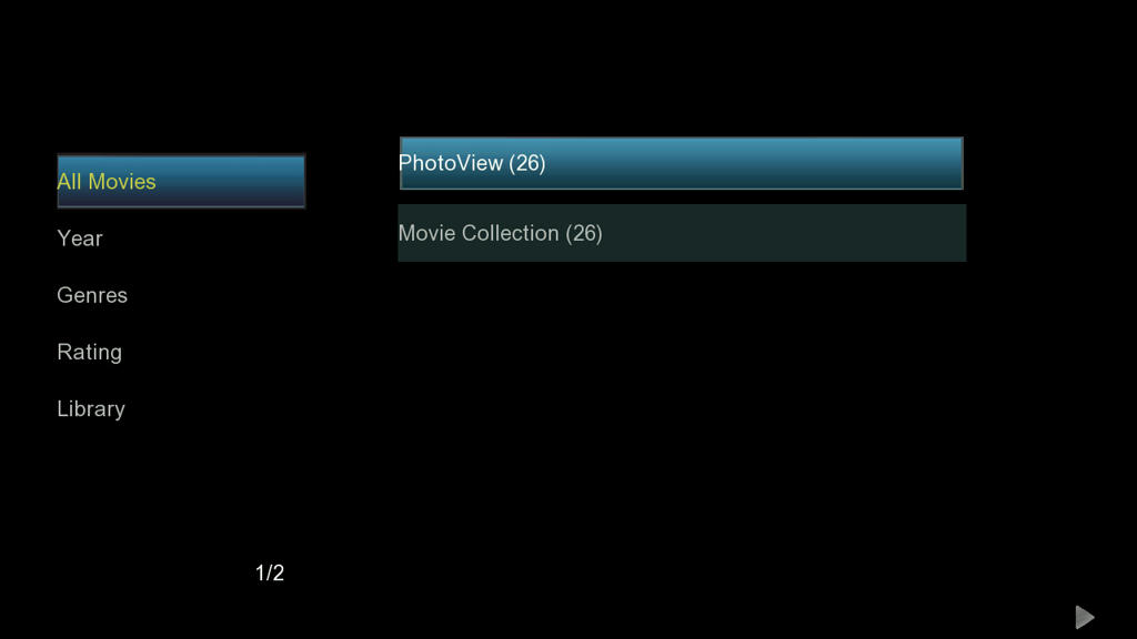

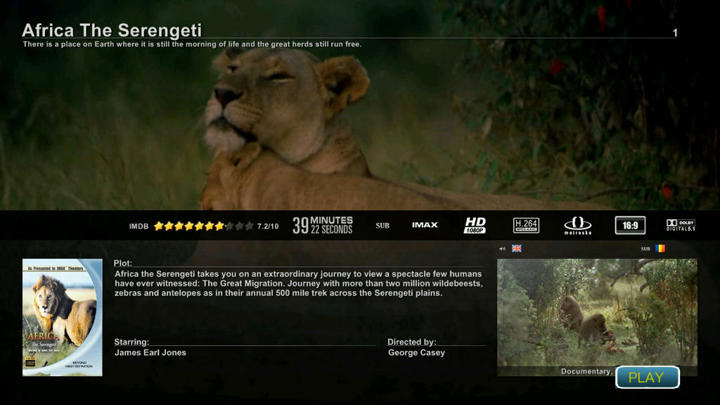

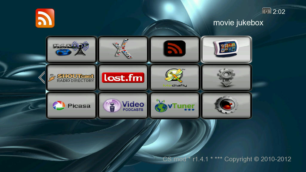

Photo Gallery because everybody ask
ACRyan Jukebox
IMS Movie Jukebox PhotoView
IMS Movie JukeboxMovieWallView
http://www.mediafire.com/2in1#0,1
