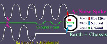

Có bài viết về vấn đề nhiễu điện khá hay, các bác xem chơi.
http://www.tangible-technology.com/power/p2/power_2.htm
As mentioned earlier, all of your gear reflects noise back into the power wiring, but if a more serious variety of noise is coming from outside your facility, the best way to tame it is with an uninterruptible power supply (UPS). A UPS converts AC power to DC by charging up batteries instead of capacitors, then converts the power back to AC. Not only is it effective at cleaning up noise, it also provides a safeguard against spikes and power failures. Remember that isolation and balanced power transformers do not filter noise, and to be truly effective, they must be properly installed where power enters the building.
Heavy Metal Noise
Balanced power enters the home as 220V to 240V. Neutral comes from a center tap on the utility pole transformer, hence our 110V to 120V standard outlet power (see Figure-9). Neutral is tied to ground as it enters the home, but it tends to get dirty from all the appliances that are constantly switching on and off (microwave oven, fridge, washer, and dryer). It's even worse in a commercial building, which may have elevators and HVAC.
A 1:1 isolation transformer can help avoid the neutral noise by taking the 220V on its primary side. A new, clean neutral is then established on the secondary side for your audio power network. It's not a big deal to add one, but it's not a DIY project. As for balanced power, I have mixed feelings. It is somewhat effective, but not a panacea. Understand that I am not looking to modify your gear, but I can say than when noise-prone gear is "fixed" it sounds better too.
All transformers that are big enough to run an entire recording area—including lights—are big, heavy, and potentially noisy. They make physical noise as well as radiated noise so location is key, preferably where the power lines enter the facility, as far away from guitars and analog tape machines as possible. Although there are project-studio-sized transformers available, do yourself a favor by consulting an electrician about the best solution for your needs, as well as the optimum place to install a transformer if you really need one.
